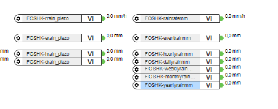

                Hi! I have WS90 array with GW2000 gateway and FOSHK plugin installed on Loxberry.
                Everything seems to work fine here, beside UDP rainfall inputs.
                I see rainfall in Ecowitt APP, I see rainfall on FOSHK plugin page (loxberry:8080), but they are not seen in Config. I've already changed Minimal change value from default 0,25 to 0,05.
                What am I missing here?

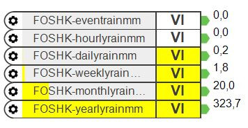

Ansichten: 436
Größe: 31,8 KB
                    Hello TomekWaw
                    When you use this, they are working well.
                    All the FOSHK-wrain_piezo and outer xxxx_piezo show me as well no data.

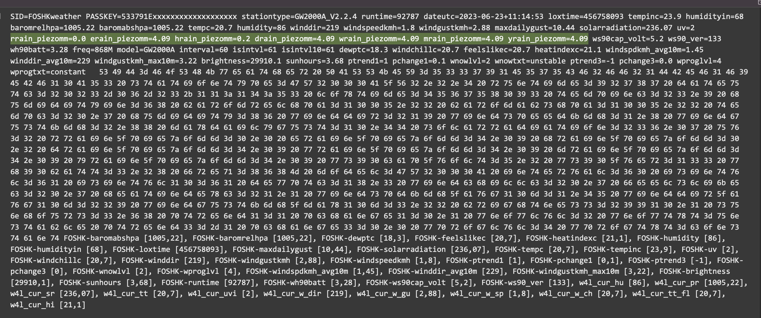

                        #507
                        olicat This is what UDP monitor shows I am receiving:
Ansichten: 478
Größe: 464,7 KB
                        So it seems there is the data, just now shown... strange

                          Hi!
                          If there is only a WS90 and no (additional) conventional rain sensor, the piezo values are automatically changed to the conventional variable names by default.
                          This behaviour can be changed in the foshkplugin.conf:
                          [Weatherstation]
                          WS90_CONVERT = True # automatically convert WS90 rain data keys to conventional rain sensor keys if only these WS90 rain values are present (globally)
                          If WS90_CONVERT is set, the conversion to the conventional names takes place:
                          rrain_piezo --> rainratein
                          erain_piezo --> eventrainin
                          hrain_piezo --> hourlyrainin
                          drain_piezo --> dailyrainin
                          wrain_piezo --> wekklyrainin
                          mrain_piezo --> monthlyrainin
                          yrain_piezo --> yearlyrainin
                          Have a look here.
                          Oliver

                            #509
                            olicat Ok, I've found the bug. Template generator puts SID=FOSHKweather\idrain_piezo=\i\v in command recognition, and in fact it should be SID=FOSHKweather\idrain_piezomm=\i\v
                            So all template names miss "mm" at the end.
