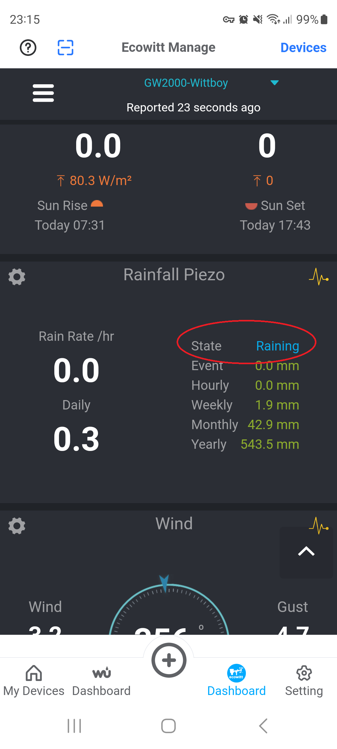

    Hat es diesen State bei der Regenerkennung beim Wittboy immer schon gegeben? Oder ist mir der gerade erst aufgefallen?
Ansichten: 384
Größe: 228,0 KB
    • olicat
      olicat kommentierte
      Das gibt es erst seit Anfang September - mit Firmware v3.1.5 des GW2000.

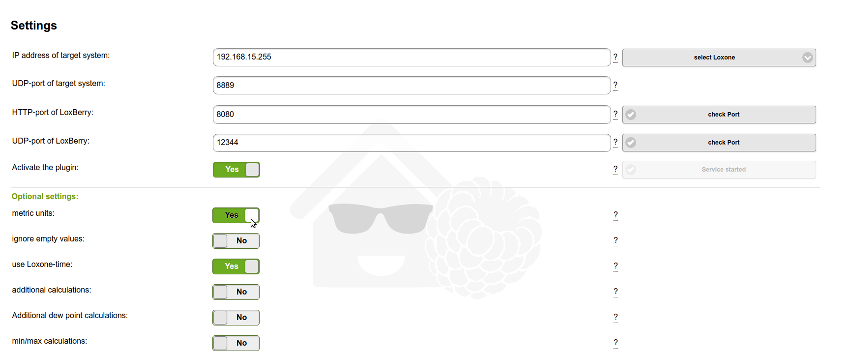

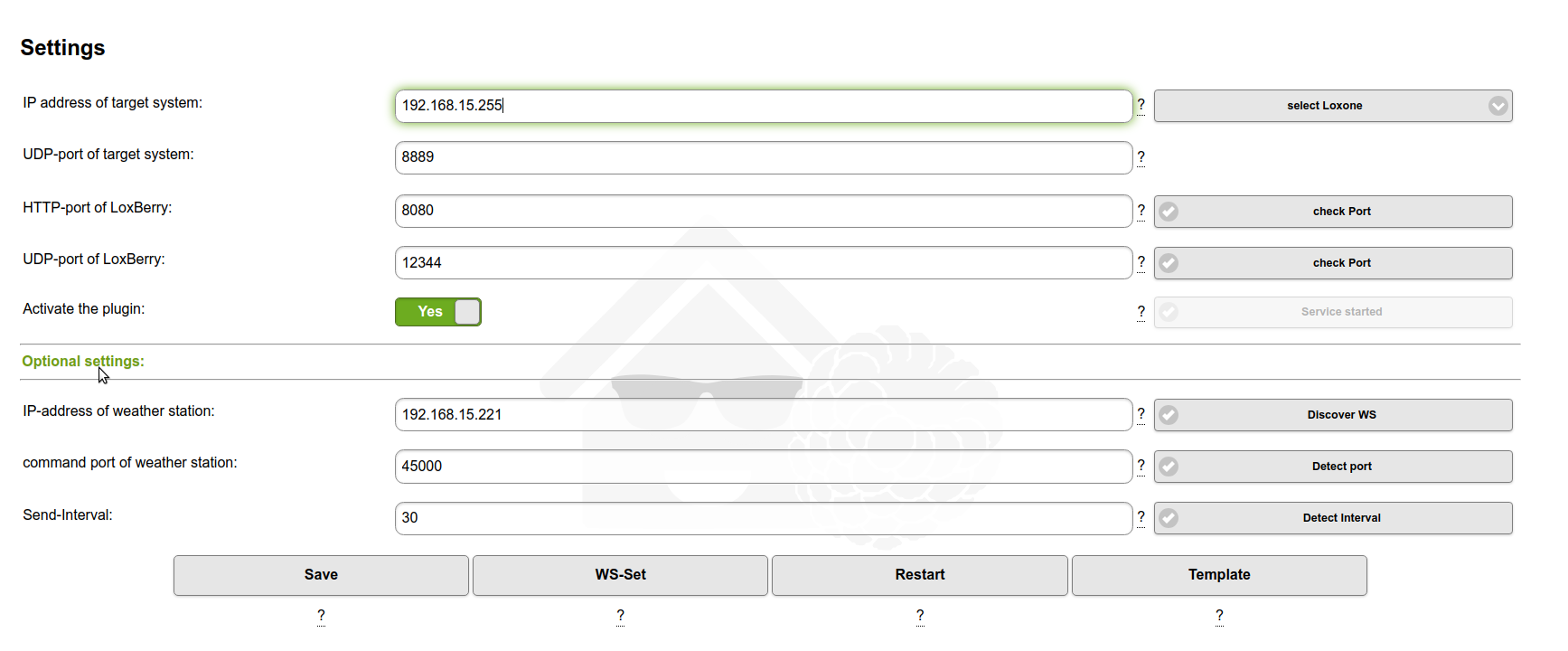

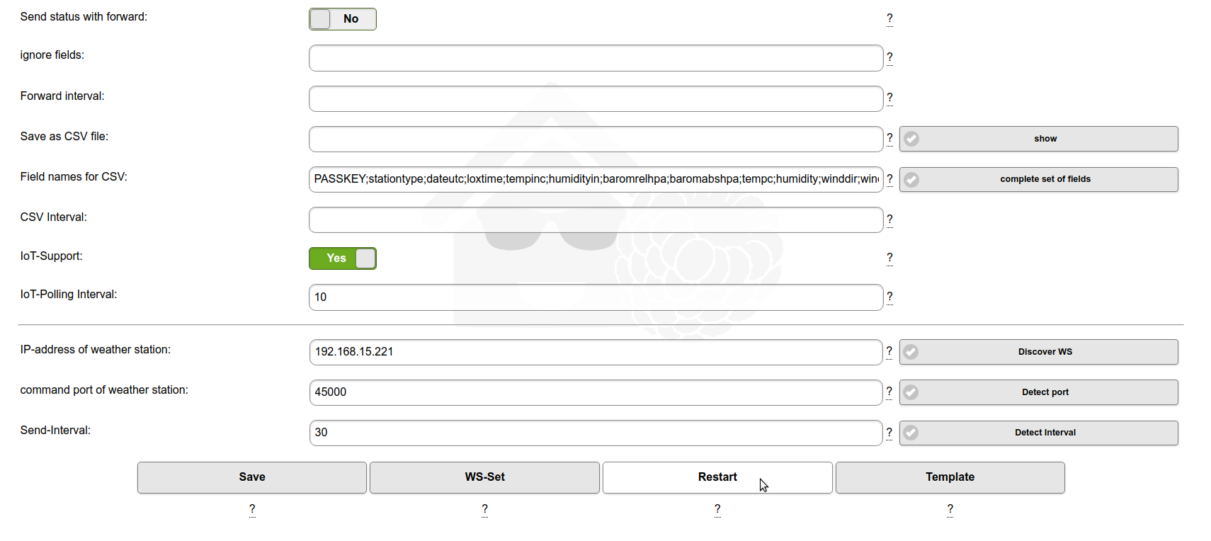

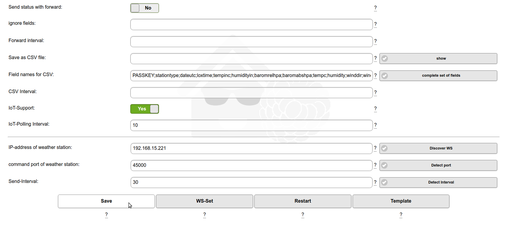

            Hi!
            Please forgive me, I have no idea.
            Of course, changing the configuration should work - especially when the service status is stopped.
            The changes are made via the LoxBerry interface as shown in the screenshots a1..a5:
            1. Enter the broadcast address under "IP address of target system:"
            2. open the advanced settings via "Optional settings:"
            3. activate the metric units via "metric units:"
            4. save the changed settings by clicking on "Save"
            5. restart FOSHKplugin via "Restart" to activate the changed settings
            Alternative:
            The foshkplugin.conf file in the /opt/loxberry/config/plugins/foshkplugin/ folder can be changed on the console in the LoxBerry version.
            To be on the safe side, you should first stop the service with a
            sudo service foshkplugin stop
            Under [Config] the configuration setting of USE_METRIC should be set to True and the file saved.
            The FOSHKplugin service should then be restarted with a
            sudo service foshkplugin start
            Regards, Oliver
