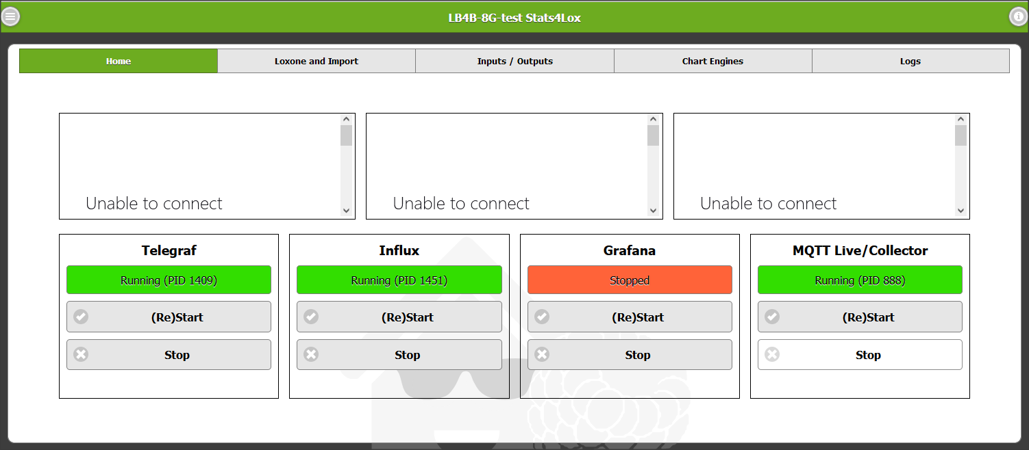

                    I tried to install the new 0.9.7.zip version of Stat4Lox. The installation passed correctly, but unfortunately Grafana stops almost immediately.
                    The installation I also tried an older Raspberry 4B/4G and a brand new 4B/8G also.
                    I installed "loxberry-image-rasppi-2.2.0d_pippin.img" on the old machine and "loxberry-image-rasppi-2.2.0e_pippin.img" to the new one.
                    I updated the Loxberry version to the current one.
                    Next I did set the:
                    - network and hostname
                    - the miniserver account
                    - SMTP sending
                    I installed
                    - the MQTT plugin
                    - and on the older board Zigbee2Mqtt plugin.
                    In both cases, the stat4lox installer runs without error, starting services, but Grafana shuts down almost immediately. If I restart it turns green for a while and then stops again.
                    I don't see any abnormalities in the logfiles.
                    What can I do to start the system in my current environment?
                    Regards,
                    Gábor

                    • Patchy
                      Patchy kommentierte
                      I have the same Problem.
                      Rasperry Pi4, ging 10-14 Tage ohne Probleme dann wurden keine Graphen mehr angezeigt, Neustart,... hat nichts geholfen
                      Neue SD Karte, neues Loxberry Image und nur Stats4Lox Installiert,
                      Grafana geht sofort auf Stopp,
                      Neustart, ... nochmal neu installiert, das selbe Problem.
                      Neuer Versuch mit neuer SD und Pi 3B,
                      Selbiges,
                      Ich warte mal auf eine neue Version :-/
                    • HDready
                      HDready kommentierte
                      ich habe leider den gleichen Fehler - Grafana geht sofort auf STOP und stoppt bei jedem Neustart sofort wieder. Auch eine Deinstallation des Plugins hat nicht geholfen....
                      lg David

                    Finally, I found a working procedure for installation:
                    I started with the new "loxberry-image-rasppi-2.2.0e_pippin.img" image and installed an older 4GB on Pi4B. I set the:
                    Next I did set the:
                    - SMTP sending I installed
                    - the MQTT plugin
                    And not installed the Zigbee2MQTT plugin.
                    I then installed the stat4lox plugin. It works now.
                    Now comes the difficulty: I'm trying to put Z2M next to it. (Before that, of course, I make an image.)
