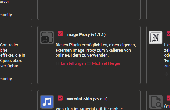

        Do you also don't have Spotify albums and bands images in Loxone UI? The reason seems to be that when I access my loxone server locally over IP it immediately switches to their dyns dns (links as https://10-0-2-81.(...).dyndns.loxonecloud.com/#/(...)) which is over https but all Spotify images that music4home are served via http (i.e. http://10.0.2.55:7092/http://10.0.2.....jpg/image.jpg). Having http stuff in a https makes browsers to reject to load it. Having an exception doesn't help. The same problem is in the native app. It seems that music4home sets up this proxy server on 7092 which is over http and this doesn't work well with Loxone. Is it only my setup or a bug?
          • 2714
          #350
          I am not fully into this, but i think that this has nothing to do with the MS4H itself because the Image and Image Proxy handling is done by the LMS itself and not by a component of the MS4H, or am i wrong ???
          BTW:
          With the LMS Plugin Image Proxy you can modify and add own ImageProxy Server locations to the LMS
          Klicke auf die Grafik für eine vergrößerte Ansicht  Name: ImageProxy.png Ansichten: 0 Größe: 34,5 KB ID: 455399
          • c4yc0
            • 08.02.2024
            • 18
            #351
            You are partly right - LMS is managing these images but there is another proxy server at 7092 that sends request to it. These are on musc4home and they forward requests to the one on the LMS.
            You can see that also in the link I provided, that you can see in Loxone's html page:
            http://10.0.2.55:7092/http://10.0.2.55:9000/imageproxy/https://t.scdn.co/media/derived/rock_9ce79e0a4ef901bbd10494f5b855d3cc_0_0_274_274.jpg/image.jpg
            . The first part of the list is http proxy at 7092 - set up by music4home by cors_proxy.createServer().listen(config.cors_port) in opt/music_server/msg/service/music-server/index.js. That's why I suspect it might be problem that other experience when accessing through loxone dyn dns.
              • 2714
              #352
              Sorry, it seems this is related to the MusikServerGateway (MSG) only.
              I don't use MSG for good reason, you never know how long this feature will last before loxone will do anything against it.
              I only use the LMS Web interface additionally with control from Loxone MS over UDP / VI...

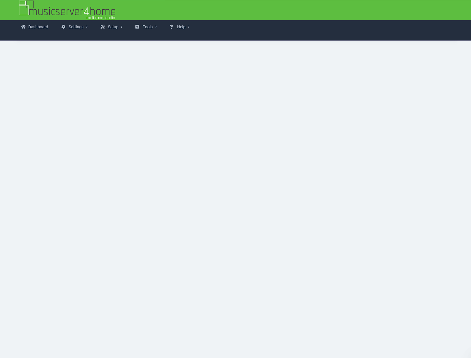

                  Ich habe ein Raspberry Pi 4 mit DietPi. Darauf habe ich den LyrionMusicServer v9.0.2 sowie die neueste Version von MS4H installiert.
                  Nach der Installation hatte ich zunächst Probleme mit Apache, da die Webseite nach der MS4H-Installation im Browser nicht richtig angezeigt wurde – dieses Problem habe ich mittlerweile gelöst.
                  Leider funktioniert die MS4H-Webseite immer noch nicht richtig, da nur das obere Menü angezeigt wird und dieses nicht reagiert.
                  Dies ist meine erste Installation und ich habe bisher noch keine Soundkarten angeschlossen.
                    Du hast vermutlich Bookworm anstatt Bullseye installiert.
                • Tombek
                  • 07.04.2025
                  • 2
                  #355
                  Danke, du hattest recht – jetzt funktioniert es gut.

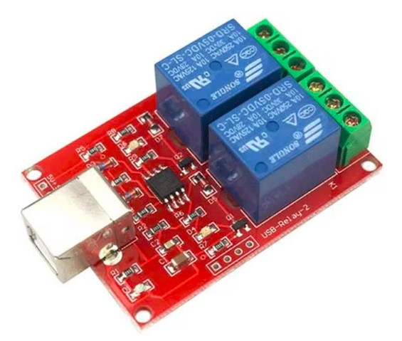

                    Hallo alle zusammen,
                    erstmal ein herzlichen Dank an hismastersvoice für dieses tolle Projekt.
                    Ich habe mir ebenfalls einen MS4H gebaut. Mein Relaiskarte wird erkannt, aber die Seriennummer wird nur als ???? dargestellt (Anhang). Wenn ich über die shell crelay -d aufrufe und im Webbrowser über das Relay Card Control das Relais steuere, funktioniert dieses. Leider stecke ich in Linux nicht so tief drin, dass ich das Problem lösen konnte. Aber vielleicht habt ihr ja einen Tipp, woran es liegt. Über einen Input freue ich mich sehr.
                    Viele Grüße und allen schöne Osterfeiertage.
                    • music4an2025
                      music4an2025 kommentierte
                      Vielen Dank für die schnelle Rückmeldung. Das ist ein 2-fach Relais Board, welches ich noch in meinem Fundus von Ali hatte. Ich glaube 2 Jahre alt. Ich habe oben noch ein Bild von dem Board angehängt.
                      Hat irgendwas mit Zeichensatz zu tun.
                      Da gab es glaube ich schonmal einen Beitrag hier im Forum
                      Labmaster kommentierte
                      @music4an2025
                      Vermutlich würde die Karte schon funktionieren, nur hat der Kartenhersteller nach der Produktion wohl keine Seriennummer vergeben so daß dort im Speicher des Microcontroller noch 0xff steht. (das dürften die komischen Sonderzeichen sein die angezeigt werden) .
                      Man kann die Seriennummer selbst beschreiben: (zumindest bei der Karte mit der Firmware welche ich hatte)
                      Ich hab das hier im Forum auch mal dokumentiert, siehe https://www.loxforum.com/forum/proje...ie-l%C3%B6sung
