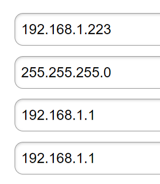

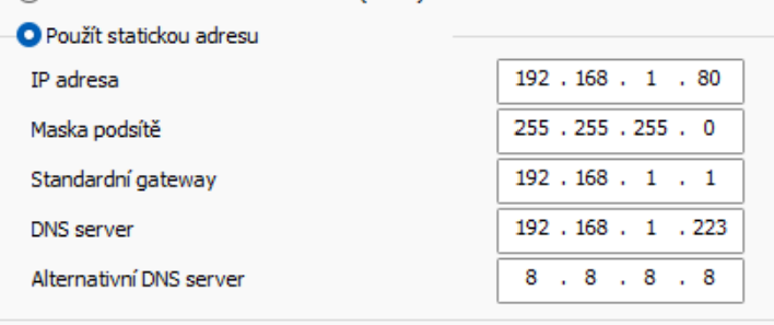

                    Does anyone else have a problem with Miniserver that not want to download the current weather data? Miniserver version is 13.1.9.28. Weather data have freezed approx a week ago. I have no problem to download OpenWeatherMap 3.0 API data, the weather emulator works also fine, but the MS did not ask for the data. What can be wrong. Has Loxone changed something?
                    Same answer as always: If your LoxBerry DNS was not available by the Miniserver, it switches to fallback DNS server (second DNS) and never go back until you restart the miniserver.
                  #880
                  Hi Mobilux, Thanks for quick reply. Please see the Loxberry network and miniserver settings. What can be wrong? MS was restarted several times during the day.
                  Click image for larger version  Name:	image.png Views:	2 Size:	19.6 KB ID:	359890Click image for larger version  Name:	image.png Views:	2 Size:	22.0 KB ID:	359891​​
                  Zuletzt geändert von Gast; 05.10.2022, 17:29. Grund: Loxberry IP is 192.168.1.223, GW 192.168.1.1. and DNS 192.168.1.. MS is 192.168.1.80
                    What IP is what server?! Please send also the field names.

                  Loxberry network settings

                  MS network settings​​

                    Ah, ok. So the IP of your LoxBerry is 192.168.1.223. You should use this one for both DNS addresses in Miniserver. So replace Google's DNS 8.8.8.8 with the LoxBerry DNS server. This way MS cannot use Google's DNS as fallback.
                    But you have to make sure that the DNSMask Service is running on the LoxBerry first. So have you enabled the Weather emulator? Does the test button work in the plugin settings (emulator)?
                      Changed as recommended. DNSMask service is installed and running on the LoxBerry, Weather emulator is enabled and the button work in the plugin settings. Now we have to wait.
                      It seems that the trick with the DNS setting did not helped. The weather is still presented with the old values. FYI until the last Loxone update everything worked perfectly fine even with the second DNS as Google's DNS and without DNSMask.
                      The problem is that the is no request from the MS in LoxBerry Weather4Loxone logfile. What FW version of MS you have?
                      12.2

                    Hello Dan35, I have exactly the same issue. With the latest beta 13.1.9.28 the Weather Service stopped working. I checked on my firewall and Loxone is using the internal DNS, but in the logs on the LoxBerry I see no request. Only requests from my tests are shown there. After digging deeper and checking the DNS logs, I saw that Loxone is requesting data on weather-beta.loxone.com and not weather.loxone.com. So you have to add this DNS entry if you are using the beta version of Loxone Miniserver.
                    Maybe this could be added to the wiki?
                      Weather Service working again. Thank you!
