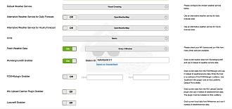

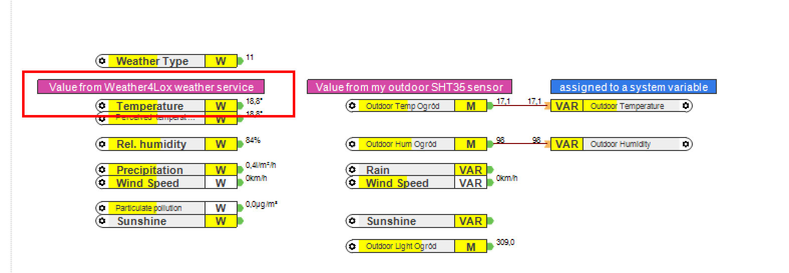

                  Hi, I have a hard time understanding how things work here.
                  I use Visual Crossing for forecast (A), with current data overwritten with nearby WU station (B). In addition to that I overwrite outdoor temperature with my own SHT35 sensor (C).
                  Result:
                  - my SHT35 sensor almost perfectly matches nearby WU station temperature (with a difference usually within 0.1 deg C). So C=B.
                  - Loxone Apps shows value C in weather section (and this is perfect)
                  - Plugin plugins/weather4lox/webpage.html shows value B (and this is reasonable)
                  - BUT weather server temperature input in Loxone Config shows a very different temperature - currently 1,4 reg C lower! I'm not sure if this is A, but this is not OK. To my understanding it should show either B or C (B most probably).
                  What am I missing here?

                    • 5368
                    #1044
                    Originally this value is from the Loxone Weather Service (in your case from the LoxBerry Weather Service). Since you use a WU station in the Plugin, this temperature is in your case the one from the WU station OR (depending of your plugin configuration) the measurement from your SHT35 (if you enabled the Loxone grabber in the plugin). The sequence the plugin uses the different values is as follows:
                    1. Weather data from the weather service
                    2. If enabled: the data is overwritten by the Wunderground grabber
                    3. If enabled: the data is overwritten by the FOSHKplugin Grabber (another LoxBerry Plugin)
                    4. If enabled: the data is overwritten by the WU Upload Catcher Grabber (another LoxBerry Plugin)
                    5. If enabled: the data is overwritten by the Loxone Grabber
                    So if I understand your setup correctly, the data from Visual Crossing is first overwritten by the WU station near to you and then overwritten again by the data from the Loxone Grabber (so temperature from your SHT35). This is then the data the plugin sends to the MIniserver.
                    The fact that you see a difference between your SHT25 and the "W - Temperature" block is, that Loxone only grabs the data from the plugin once an hour. So worst case the value is 60 minutes old.

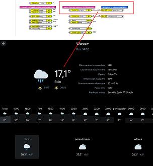

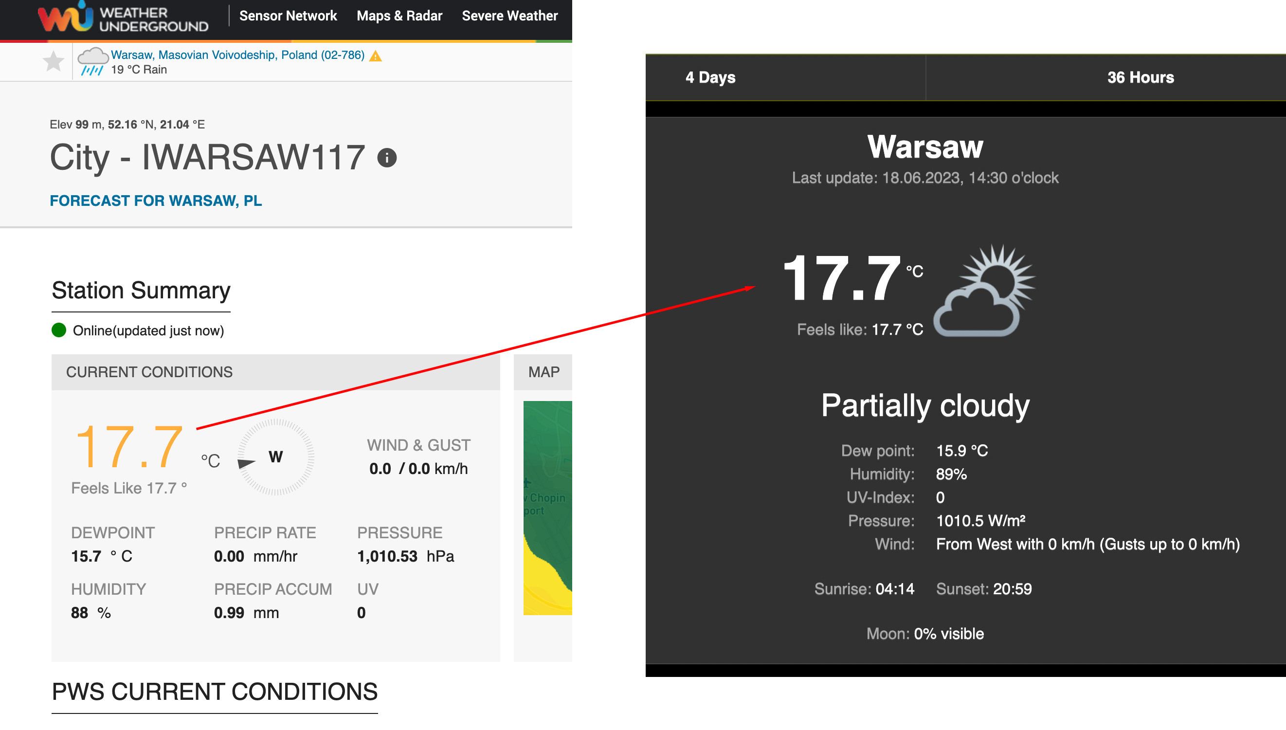

                      #1045
                      Prof.Mobilux Thanks for your answer. I thought it works this way but apparently it isn't in my case. Here's my configuration:
Ansichten: 710
Größe: 217,9 KB
                      So I overwrite current weather data with WU Grabber, but do not overwrite (current weather service data) with Loxone Grabber.
                      I only have Temp and Humidity, so I just assign SHT sensor value to VAR temperature and humidity. That seems to work to have it system-wide.
                      What worries me is why Weather Service (W) temperature input is so off.
                      I know that Miniserver pulls that only once per hour, but I've checked it several times in minute :00, :01 and :05 and it is still off buy a large margin.
                      The screenshot I've posted before was taken in minute :02, so is should match.
                      To my observations the difference keeps has been staying in range ~1.5-2 deg C most of the time during last 2 days and I hardly believe temperature changes 1.5-2 deg C every hour.
                      I do another set of screenshots right now (time is 15:02 - just after full hour):
                      My Outdoor SHT Sensor shows 17.7 deg C and this temperature is shown by loxone app:
Ansichten: 617
Größe: 426,0 KB
                      Nearby WU station shows 17.7 deg C and this temperature is shown by plugin webpage:
Ansichten: 631
Größe: 376,4 KB
                      So I'd expect to see 17.7 also in [W] (current) temperature input. But instead, 18.8 deg C (!) is shown.
Ansichten: 629
Größe: 172,8 KB
                      So this is off by 1.1 deg C. How come?

                      • 5368
                      #1046
                      Reaty don't know. This VAR is set by Loxone. But Loxone grabs around full hour as far as I have seen +15 minutes. So waiting 2 minutes is not enough.
                      Why not jsut ignoring it?! You don't need this variable as long as you use the systemwide outside temperature VAR.
                      Zuletzt geändert von Prof.Mobilux; 18.06.2023, 19:05.

                        Prof.Mobilux Unfortunately I can't just ignore it because of those 2 reasons:
                        1) If I wouldn't have my own outdoor SHT sensor - I wound never have exact temperature in my system (from nearby WU station). This makes using plugin (and WU current data overwrite) pointless, doesn't it?
                        2) Yes, because (and only because) I have my own SHT sensor in Loxone, I might ignore current temperature and humidity values from Weather.
                        But I don't have lot of other weather measurements and not all weather inputs are exposed to system as VARs.
                        Perceived temperature, Pressure, Radiation, Wind Direction, Particulate polution - they all are available only as Weather inputs.
                        And they all are off / not usable.
                          • 5368
                          #1048
                          Use "cur_tt" Input from the plugin and you are fine. This is the temperature fromn the WU station (if you use the WU grabber). Or use the systemwide outdoor temperature VAR-block which you can set by your own temperature sensor.
                          No need to use that Loxone W-block which is updated only once in an hour.

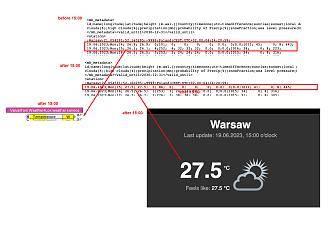

                          Guys, Prof.Mobilux might be right here, its a matter of how Loxone polls that data. See screenshot below:
                          Click image for larger version  Name:	w33.jpg Views:	0 Size:	383.8 KB ID:	394531
                          So somewhere close to minute :00 raws in this xml shift up.
                          As I understand this, WU Station always overwrites the top row (weather in current hour).
                          But before plugin does this (usually every 3 minuts) it seems that Loxone polls it just before.
                          So here 26.1 deg was at the top row for a minute or two and than the row has been overwritten with WU current data.
                          But 26.1 will be kept by Loxone for next hour (15.00-16.00).
                          Perhaps kind-of solution to this would be never letting Loxone read the top row if it was second row before (= before overwrite).
                          So if any overwrites are used, the row shift should be preceded with WU Station forced call and data overwrite first.
                          That would not make the weather data in Loxone perfect for whole hour, but at least it would make them as close to exact as possible for first part of the hour.
                          Prof.Mobilux do you think it's possible?

                            TomekWaw Problem is that you never know when Loxone will grab for new data. It can take up to 15 minutes (as I have seen so far). And the different sources (UDP inputs, HTTP inputs, Weather WebPage, Weather Service Emulator) are all feed from the same internal plugin database. No chance to just update one of them.
                            But as already mentioned before you do not need that silly W-block - even if you have no own temperature sensor.

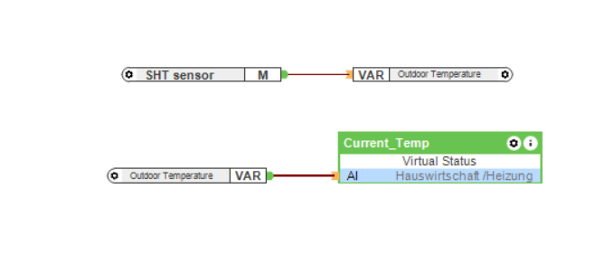

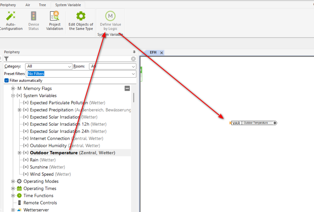

                            Mark the "System Variable --> Outdoor Temperature" in the Periphery Tree, click "Define Value by Logic" and drag it into your program:
                            Klicke auf die Grafik für eine vergrößerte Ansicht  Name: image.png Ansichten: 0 Größe: 205,7 KB ID: 394542
                            If you want to use your own temperature sensor, feed the new VAR block with the output of your sensor. The VAR block is updated as soon as the value of the sensor changed. You can use it as outdoor temperature in your whole program.
                            Klicke auf die Grafik für eine vergrößerte Ansicht  Name: image.png Ansichten: 0 Größe: 23,8 KB ID: 394543

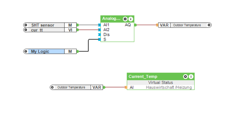

                            If you do not have an own sensor or if the sensor is broken, just create a Virtual UDP input with "cur_tt" from the plugin and use this one as input for the system variable. cur_tt is the temperature from the WU station if you use the WU grabber. Again the system variable is updated as soon as the plugin has new data available.
                            Klicke auf die Grafik für eine vergrößerte Ansicht  Name: image.png Ansichten: 0 Größe: 23,1 KB ID: 394544
                            You can also build a logic to select one of the two sources (sensor or WU station) with a Analogue Multiplexer - depending of e.g. if the sensor health is OK or not. Note that in all cases your program stays the same, only the input of the VAR block changes.
                            Klicke auf die Grafik für eine vergrößerte Ansicht  Name: image.png Ansichten: 0 Größe: 37,4 KB ID: 394546
                            I never used that scary W-block from the Loxone weatherserver, because it holds outdated data and you never know what you get.​​
