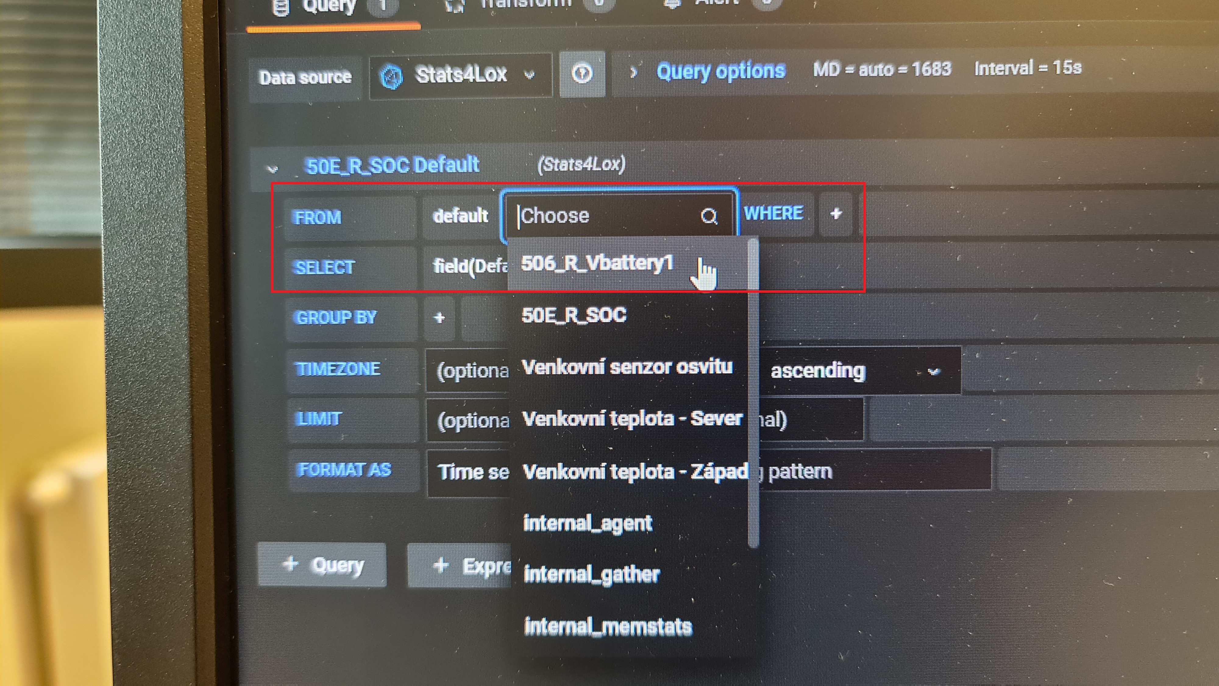

                I wanted to ask how I can remove from ( select measurements ) a data collection no longer in use.
                Thank you in advance for the information.​
Ansichten: 542
Größe: 2,20 MB
                  No, this is currently not possible from the plugin. You can use influx command line but I would not recommend this if you are not familiar with unflux database. Just let it as is - it will not use much space.
