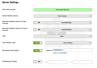

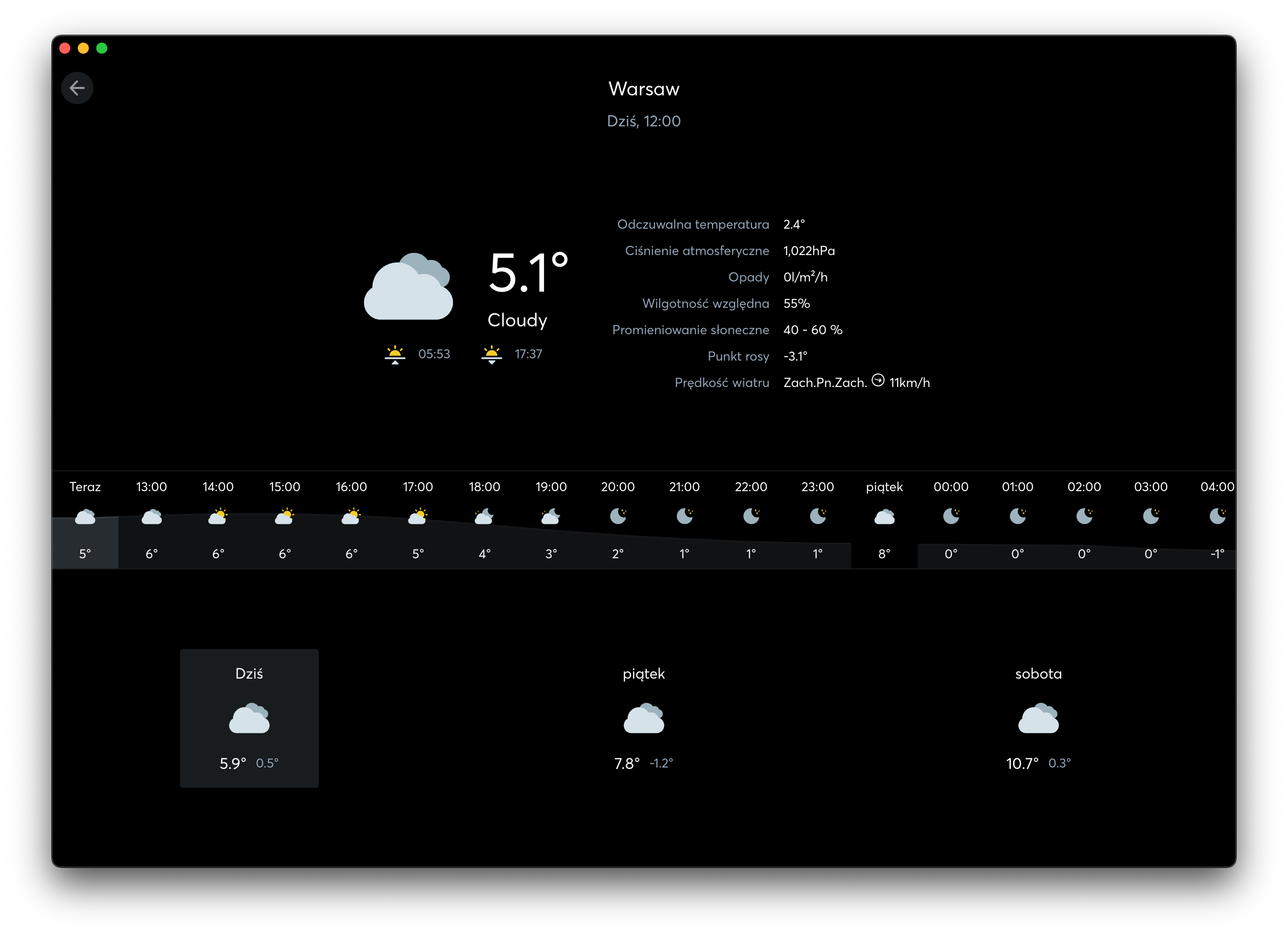

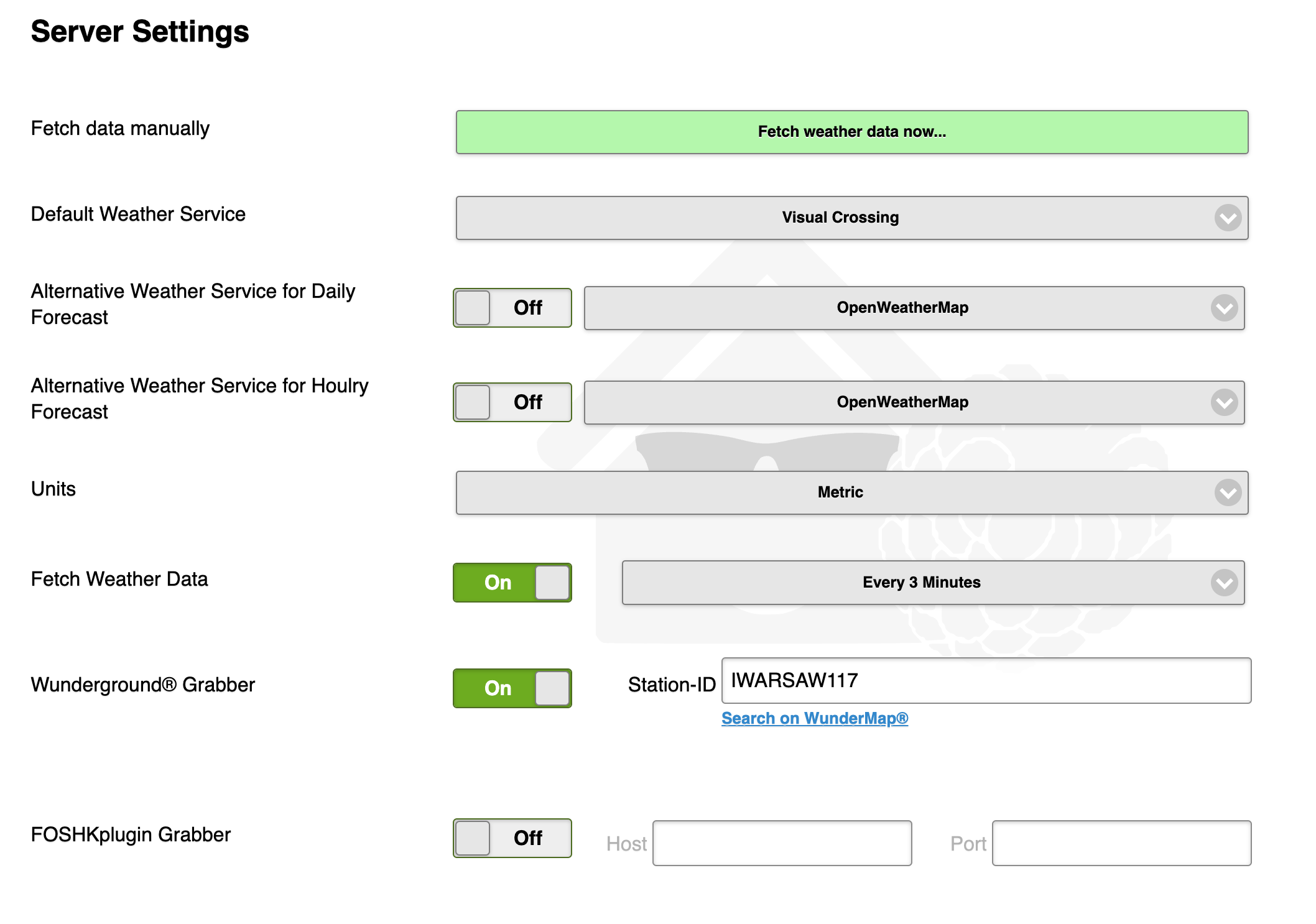

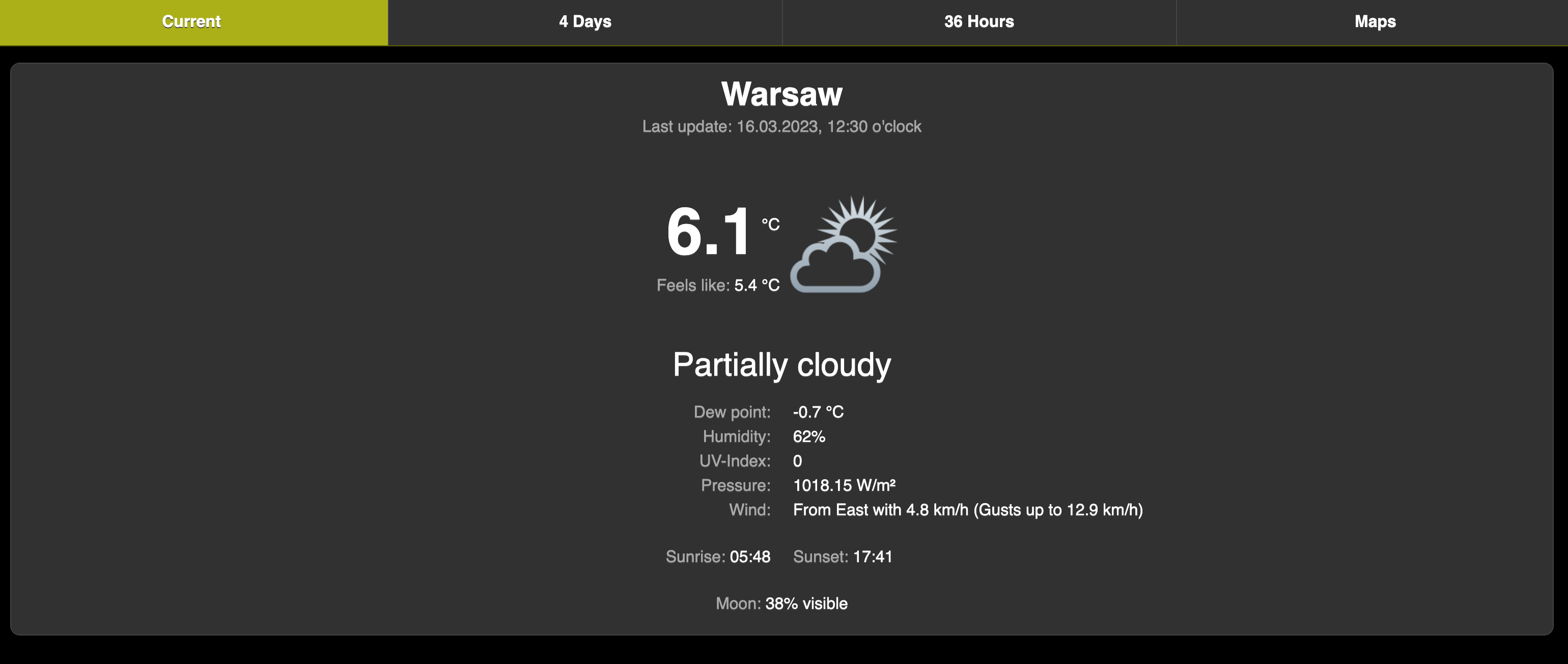

                    Hi!
                    I can't figure out why weather in Loxone app doesn't show current correct current data overridden from near Wunderground station.
                    I have this config:
                    Click image for larger version  Name:	Zrzut ekranu 2023-03-16 o 13.00.40.png Views:	0 Size:	199.0 KB ID:	383054
                    So I use Visual Crossing for the weather forecast (including daily and hourly - good enough for me), but I override current weather data with a Wunderground station that is very accurate (Davis Vantage Pro2) and is very close to my home.
                    Current temperature from this station is: 6.4 (and feels like 5.4). This is correctly shown on the emulator:
                    Click image for larger version  Name:	Zrzut ekranu 2023-03-16 o 13.01.01.png Views:	0 Size:	165.9 KB ID:	383055
                    But in the app is says 5.1 (and feels like 2.4) - this is still from Visual Crossing station that is from station several kilometers from my location:
                    Click image for larger version  Name:	Zrzut ekranu 2023-03-16 o 13.01.21.png Views:	0 Size:	399.8 KB ID:	383056

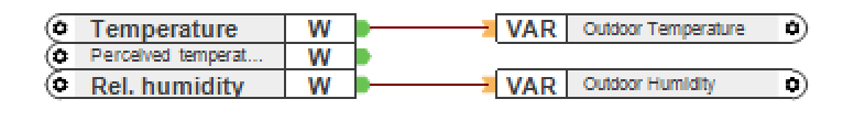

                    In Loxone Config I have Weather data connected to system system variables:
                    Click image for larger version  Name:	Zrzut ekranu 2023-03-16 o 13.09.50.png Views:	0 Size:	9.4 KB ID:	383059
                    What am I doing wrong here?
