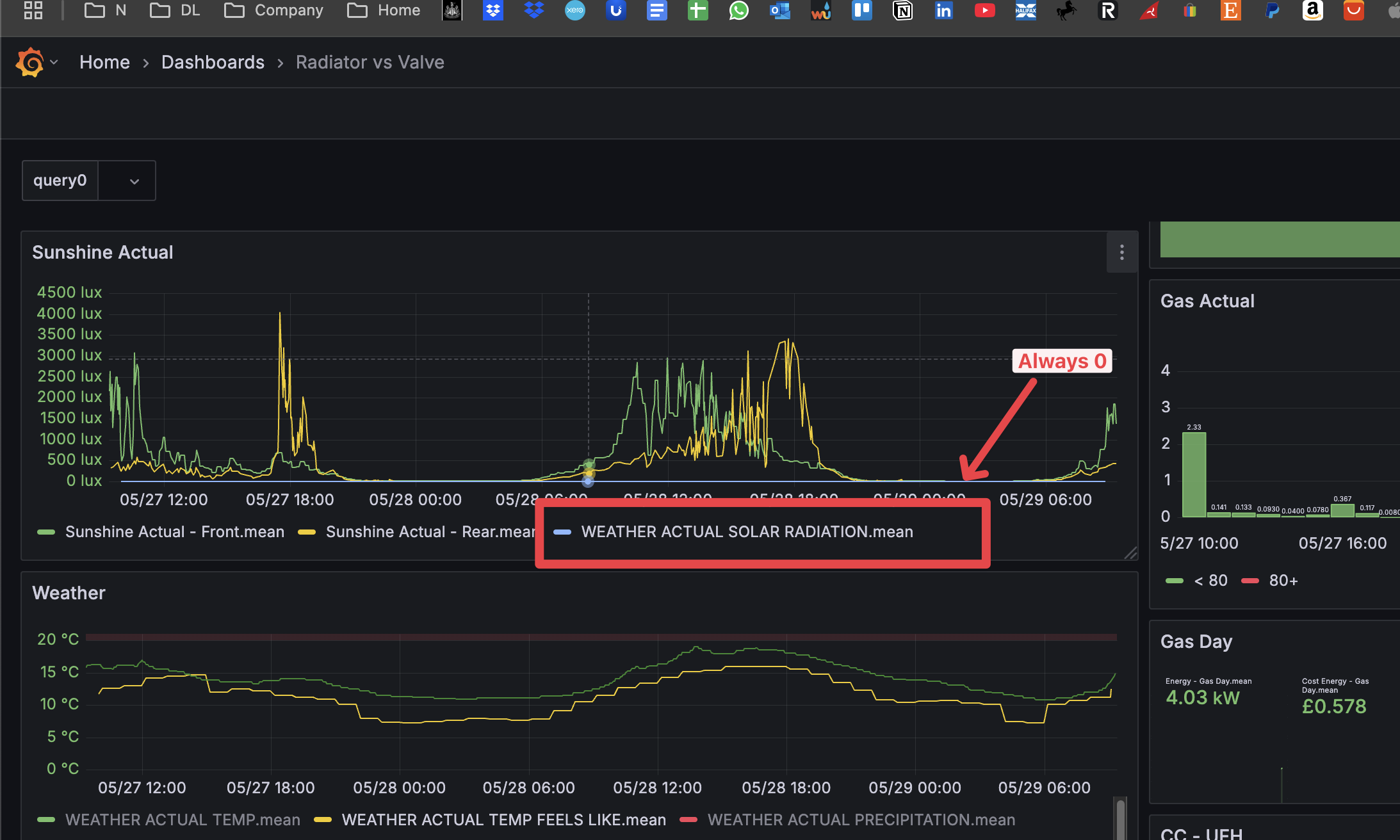

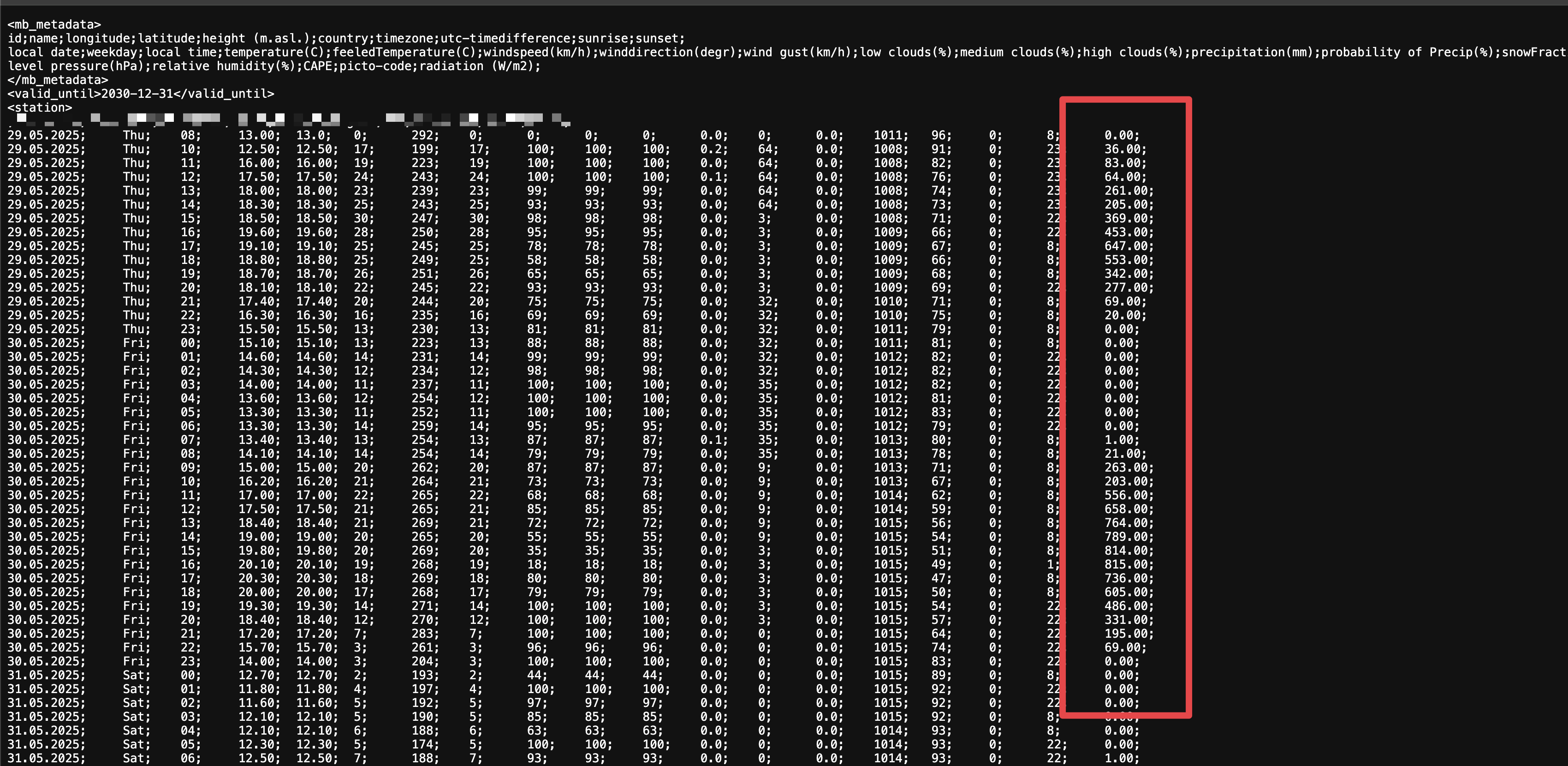

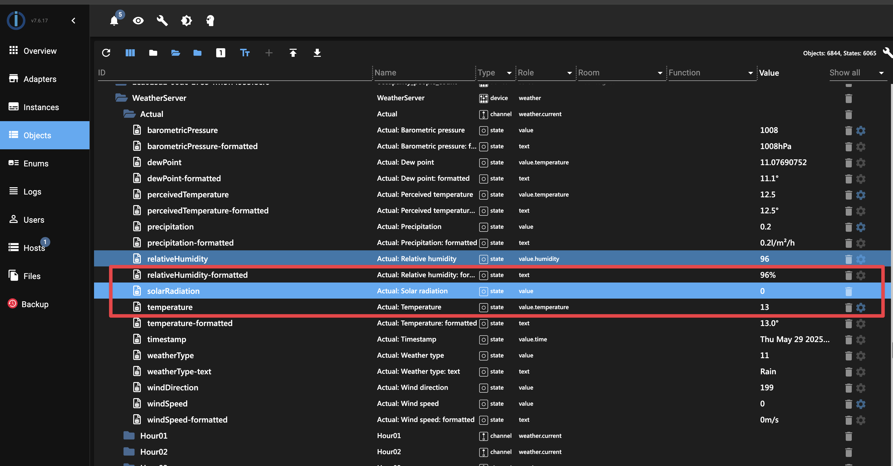

              Hye Guys.
              I'm sorry for the English, as usual.
              I',m not sure if the solar radiation information is working correctly for me:
              I can see the radiation info when I test the w4l service:
Ansichten: 1038
Größe: 769,7 KB
              But when I read the weather from miniserver via iobroker or monitor the solar value in loxone config it is always 0.
              Also shown the radiation value in grafana showing only 0
Ansichten: 1021
Größe: 491,8 KB
Ansichten: 1027
Größe: 244,7 KB
              Am I doing something wrong or is this a bug?
              TIA!
