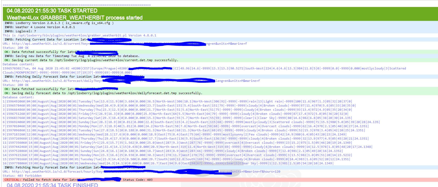

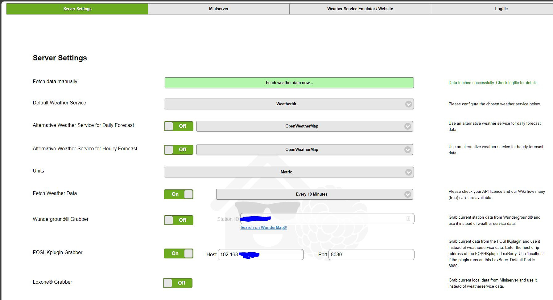

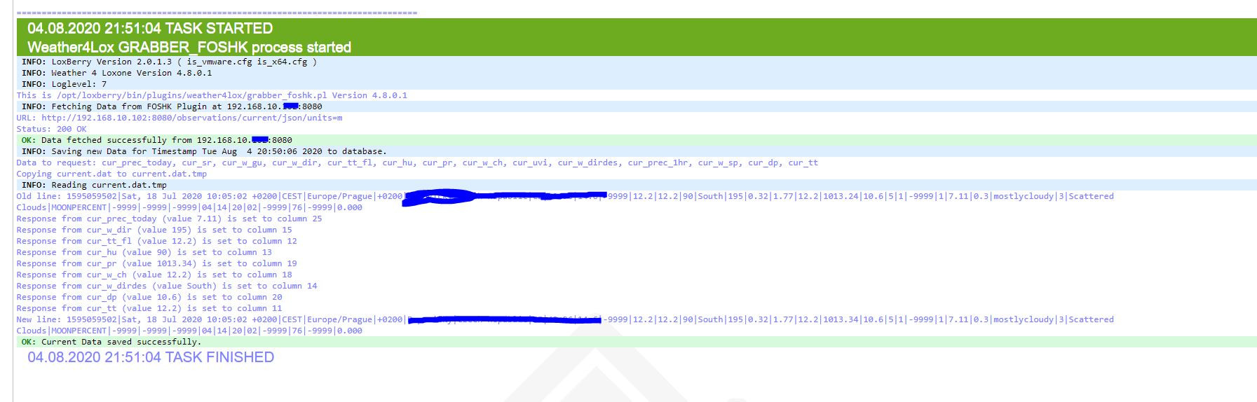

      • killeriq
        • 97
        #560
        Zitat von killeriq
        Hmm I was thinking if i have my own Weather Station, why should i even use some 3rd party Weather service (OpenWeatherMap, WeatherBit, Dark Sky) somewhere "close to me".
        I was in impression if i dont enter anything it skips 3 online services and will take data from GRABBERs only, which has all the data transferred directly from the chosen Weather Station.
        Wunderground - ill add my station or some closest one, so it should supply the data
        FOSHKplugin send data as GRABBER - directly from connected Weather Station
        Or there is a reason to take data from Weather service (OpenWeatherMap, WeatherBit, Dark Sky) ?
        Thanks
        Hi Guys,
        After some time of working/updating state...Seems like since 18.7. are data not being updated, only thing which i did is that i updated FOSHKplugin from v0.0.5 -> v0.0.6 , but not really sure if this is the problem as i only realised recently that is not working :/
        Not sure where / what to check.
        olicat ?
        Thanks
        Zuletzt geändert von killeriq; 04.08.2020, 22:08.
        • olicat
          • 587
          #561
          Hi killeriq ,
          FOSHKplugin should have nothing to do with it.
          But there was one such case: https://www.loxforum.com/forum/proje...e24#post199411
          @Prof.Mobilux at that time said that the user in question was blocked at weatherbit.
          Maybe you made too many requests?
          jobe_grz
          Wie bist Du diesen damals Fehler losgeworden? How did you get rid of this error?
          Regards, Oliver
          Zuletzt geändert von olicat; 05.08.2020, 01:14.
          • killeriq
            killeriq kommentierte
            Thanks guys, ill try again at home.
            1. Disable Hourly Forecast in Settings should do the trick?
            2. Or completely change the provider to another one?
            olicat:
            Yeah i restarted everything already, DNS were not changed, but i can check again
            You can choose another provider just for the hourly forecast. Eg openweathermap. Rest can be still WeatherBit.
          • killeriq
            added openweathermap and seems like its working again, thanks

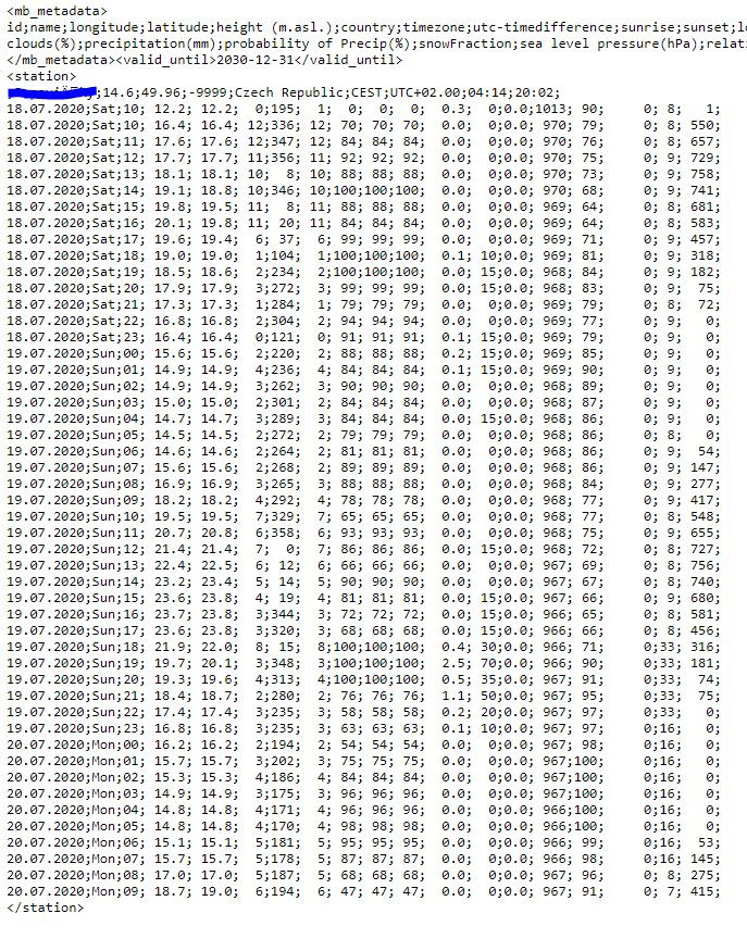

            ich brauche für die Optimierung meiner Gartenbewässerung möglichst zuverlässige Daten der Regenwahrscheinlichkeit der idealerweise der nächsten 24h.
            Ich möchte halt nicht bewässern, wenn die Wahrscheinlichkeit auf Regen > 70% ist, dann warte ich lieber noch einen Tag, um dann zu schauen, ob es tatsächlich geregnet hat.
            Ich benutze derzeit zur Berechnung der Verdunstung und des gefallenen Regens der letzten Tage die Daten aus Weather4Loxone Plugin mit Darksky als Provider.
            Das klappt gut. Für die Regenwahrscheinlichkeit gibt es einige Felder zur Auswahl die alle xxxpop@Zahlenwert in der Ausgabe stehen.
            Was bedeuten die Felder:
            cur_pop@3
            hfc12_pop@2
            hfc24_pop@12
            hfc36_pop@6
            calc+4_popmax@3
            calc+8_popmax@3
            calc+16_popmax@3
            calc+24_popmax@12
            calc+32_popmax@31
            calc+40_popmax@31
            calc+48_popmax@50
            calc+4_popmin@0
            calc+8_popmin@0
            calc+16_popmin@0
            calc+24_popmin@0
            calc+32_popmin@0
            calc+40_popmin@0
            calc+48_popmin@0
            so genau. Ich vermute hfc12... und hfc24... sind die Verhersgen für die nächsten 12 bzw. 24 h. Aber beim Rest habe ich keine Ahnung.
            Grüße aus der Steiermark
            Hans

              hansh hfc12 und hfc24 sind nicht die Vorhersagen der nächsten 12 bzw. 24 Stunden sondern die Vorhersage genau in 12h bzw. 24 Stunden (stündliche Vorhersage). Diese Daten kommen vom Wetterdienst (also in Deinem Fall von Darksky).
              calc+ sind vom Plugin kalkulierte Werte. calc+4_popmax@3 ist zum Beispiel die maximale Regenwahrscheinlichkeit innerhalb der nächsten 4 Stunden. Das Plugin schaut sich dazu die Stundenvorhersage vom Wetterprovider an und summiert die einzelnen Werte (bzw. sucht hier den höchsten Wert innerhalb des Zeitraums).
              Das Feature mit den kalkulierten Werten habe ich nie dokumentiert, weil ich die Funktion nicht wirklich geprüft hatte. Es gibt sie aber schon ewig ;-) Wenn Du die Werte bei Dir einmal kontrollierst (Vergleich mit der Webpage-Visualisierung, da hast Du ja die Stundenwerte der nächsten 36h dargestellt), dann könnte ich das auch "offiziell" doumentieren.
              Geplant waren dann auch einmal Werte calc-24h.... , wo das Plugin z. B. die letzten 24h summiert (als historische Werte sozusagen). Damit könnte man dann die Regenmenge der letzten 24h kumuliert abrufen. Das Feature ist aber nicht so einfach umzusetzen und daher noch offen.

                @Mobilux - sorry eine habe Frage noch. In der Visualisierung sehe ich pro Stunde nur die erwartete Niederschlagsmenge in l/h/m2, aber nicht mit welcher Wahrscheinlichkeit in % diese Niederschläge eintretten sollen. Auf der anderen Seite sehe ich in der Ausgabe des plugins diese Stundenwerte nicht mehr. Ich kann auch keinen Bezug der Wahrscheinlichkeiten aus calc+.... zu den Stunden-Niederschlagswerten erkennen. Hast du noch welche Ideen, woher die Wahrscheinlichkeiten stammen könnten. Ich habe mir den source code angeschaut, aber perl ist nicht wirklich meine Stärke eher C, Java und php und man bräuchte wohl auch einen Einstieg in die Gesamtstruktur.
                Die Werte in der Visualisierung haben in l/h/m2 haben bisher aber ganz gut gestimmt. Eine andere Möglichkeit wäre ie Niederschlagsmengen der nächsten 24h einfach zu addieren, die sind aber leider nicht in der Ausgabe des plugins enthalten. Gäbe es eine Möglichkeit diese Werte in Zukunft mit auszugeben ggf. statt der calc+ Werte?
                • hansh
                  • 14.03.2017
                  • 45
                  #567
                  Habe ich auch so verstanden. Die voraussichtliche statistische Regenmenge ergibt sich rein mathematisch aus der Summe der Produkte der erwarteten Regenmengen mal der jeweiligen Wahrscheinlichkeit im betrachteten Zeitraum.
                  Die Attribute calc+prec waren bisher für alle Zeiträume immer 0, obwohl es schon seit Stunden in Strömen regnet.
                  In der Visualisierung wurden dagegen recht realistische Regenmengen angezeigt. Heute Nachmittag waren die Regenmengen für heute Abend noch etwas niedrig, die wurden dann aber im Laufe der Zeit und vor dem Regen deutlich nach oben angepasst. Mit den Werten könnte ich arbeiten.
                  Die hfc Werte und die calc+popmin und popmax Werte machen mir bisher keinen Sinn und scheinen willkürlich.
