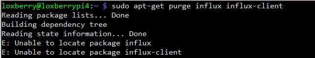

    Zitat von Prof.Mobilux
    Ok, please deinstall the plugin. Then on the command line with putty:
    sudo apt-get purge influx influx-client
    Then please try to reinstall.
    Thanks. I tried it and got the following:
    loxberry@loxberry:~ $ sudo apt-get purge influx influx-client
    Reading package lists... Done
    Building dependency tree
    Reading state information... Done
    E: Unable to locate package influx
    E: Unable to locate package influx-client

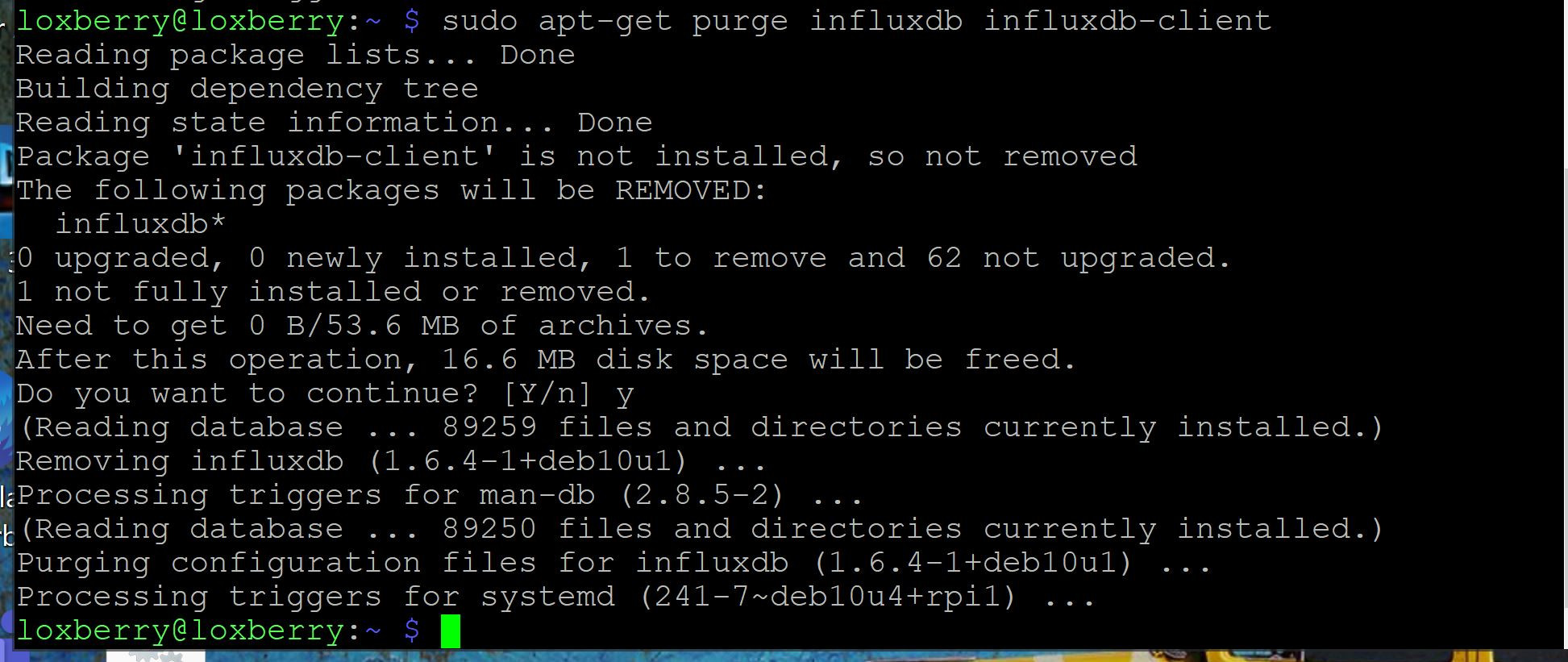

            Gast kris.de_caluwe
            Sorry, command is maybe:
            apt-get purge influxdb influxdb-client
            • kris.de_caluwe
              kris.de_caluwe kommentierte
              I did look into the issue a bit further and to me it seems to be related to the fact that influxdb cannot get its https site up and running. I did install the latest loxberry version on a spare raspberry pi 3b I had in my drawers and then installed the package and there it works like a charm ...
            #51
            Gast kris.de_caluwe
            Thanks. This (partly) worked - please see attached. However, re-install was not successful again - the same error message :-( . Any other idea what to do...?
            • kris.de_caluwe
              I did some further investigation on my system as the messages indicate it cannot access the db health pages after install . So i checked the ports in use on my system using the command
              "netstat -lptn"
              and found that on my system port 8088 was used by my FHEM api and 8086 by a docker-proxy.
              I changed my api to another port in FHEM and Loxone, uninstalled the docker plugin and then followed by the command
              "apt-get purge docker-ce docker-ce-cli containerd.io"
              and now i have the stats4lox working on my system

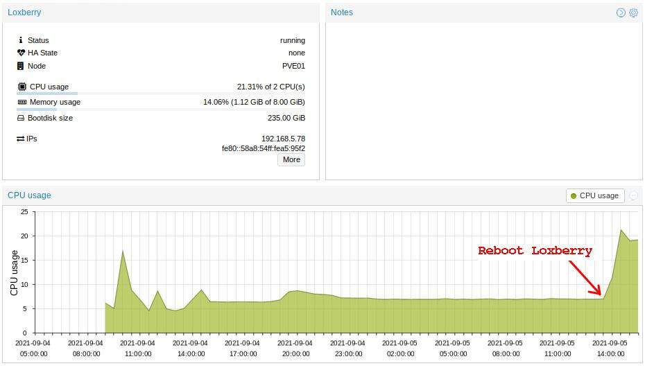

              #54
              Tach,
              wie darf/soll man 0.9.2 installieren wenn 0.9.1 schon läuft?
              "Re-Check for Updates" im Plugin Management bringt nix neues...
              Mit dem Github-Zip-Link einfach drüber installieren?
              Oder vorher 0.9.1 deinstallieren? Konfiguration+Daten bleiben (normalerweise/BETA...) auch beim deinstallieren erhalten?
              Mit 0.9.1 hab ich auch im Proxmox nach einen Loxberry reboot erhöhte CPU Usage.
Name: Loxberry CPU Reboot 01.jpg
Ansichten: 1274
Größe: 80,3 KB
              • hme0354
                hme0354 kommentierte
                Den link von #53 nehmen und drüberinstallieren
              • Houseruckiii
                Houseruckiii kommentierte
                Ok, Danke, hat soweit funktioniert! :-)

              Mit 0.9.1 (nach reboot Loxberry) startet influxdb dauernd neu,,,vmtl. daher auch Bad Gateway...?
              Die grüne Zeile scheint die Ursache zu nennen?

              • Houseruckiii
                Nice, mit 0.9.2 tritt das Problem mit höherer CPU Last nach reboot hier nicht auf :-)
